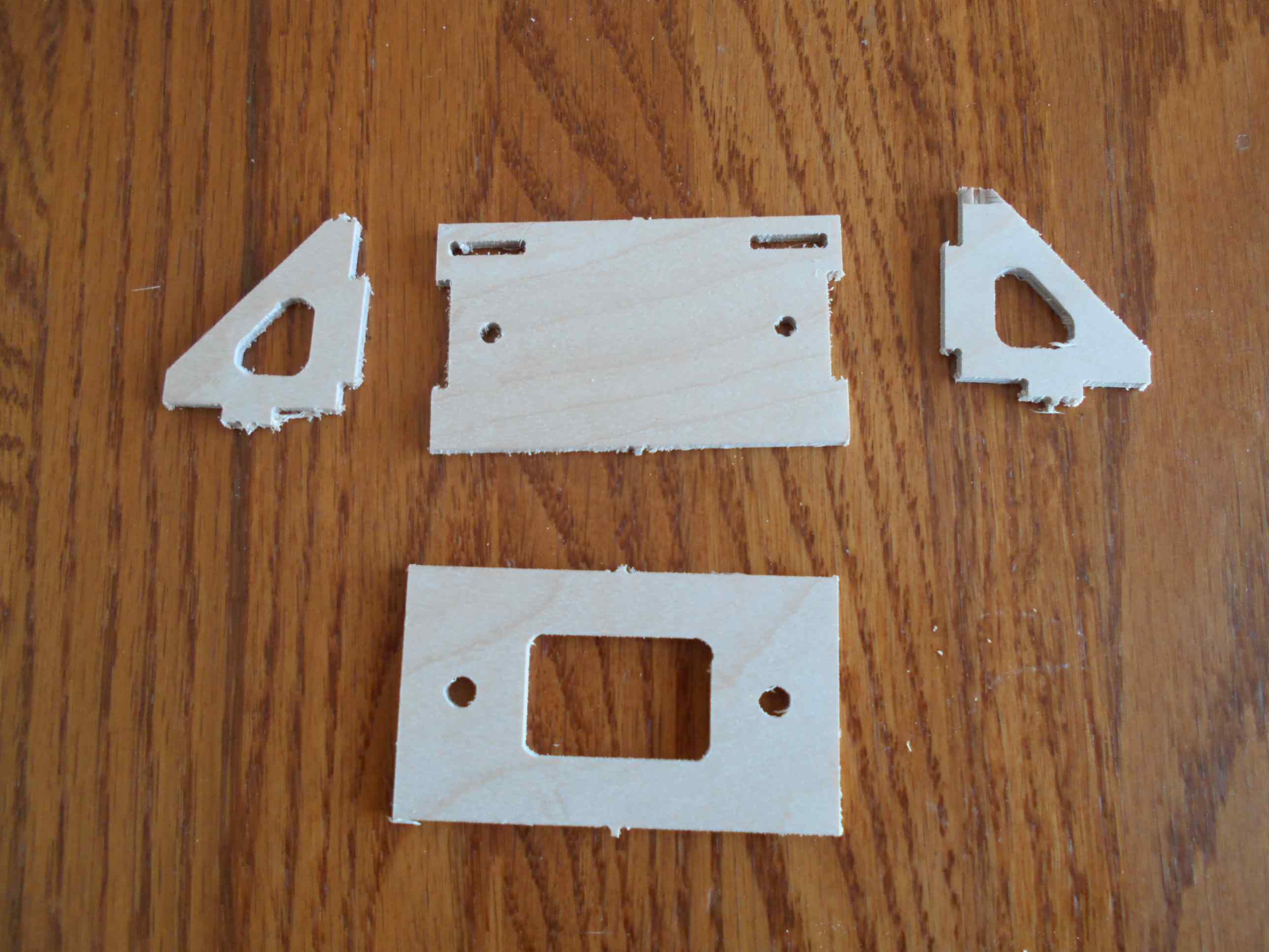

The engine I picked was the Kolm 77cc 4 Stroke with the large prop shaft extension. I did that because the cylinder head is so tall, I needed to put it as far back into the slim cowl as possible.
This choice makes it so I don't have the head hanging out on the bottom and ruining the scale look.
For future reference to new builders the distance to the FRONT of the Cowl fro the forward edge of the firewall is 185mm. If you are using a different engine that number will guide you if you will have enough room with out removing the firewall.
With the Kolm engine, that meant I had to remove 43mm and add a new firewall. The trick to making an accurate cutting line is to put the fuse rudder up and on its firewall and scribe a line all the way around. I then added two layers of 1/4 inch flexible tape to help me guide the Dremel diamond wheel as I cut the nose off.
There is a lot of discussion in some of the other build threads about how much offset needs to be built in. NONE NONE NONE! This information is right from CARF.
I built the firewall from 1/2 inch Birch plywood. I laminated the edges and inside with WEST Epoxy (slow cure) and added WEST 2 inch wide carbon fiber strips to give it extra strength. On the outside I put Finishing Epoxy to completely fuel proof it.
Here are the weights before and after.
ORIGINAL FUSELAGE 1350 grams
ORIGINAL FIBERGLASSFIREWALL REMOVED 66 grams
ORIGINAL WOOD FIREWALL SUPPLIED BY CARF 106 grams (but no glue or reinforcing tape)
NEW FUSELAGE WITH NEW FIREWALL 1620 grams.
So I have added a total of 270 grams. It would have been 170 grams with the CARF Firewall system as it is somewhat thinner.
At least the weight addition is up front.

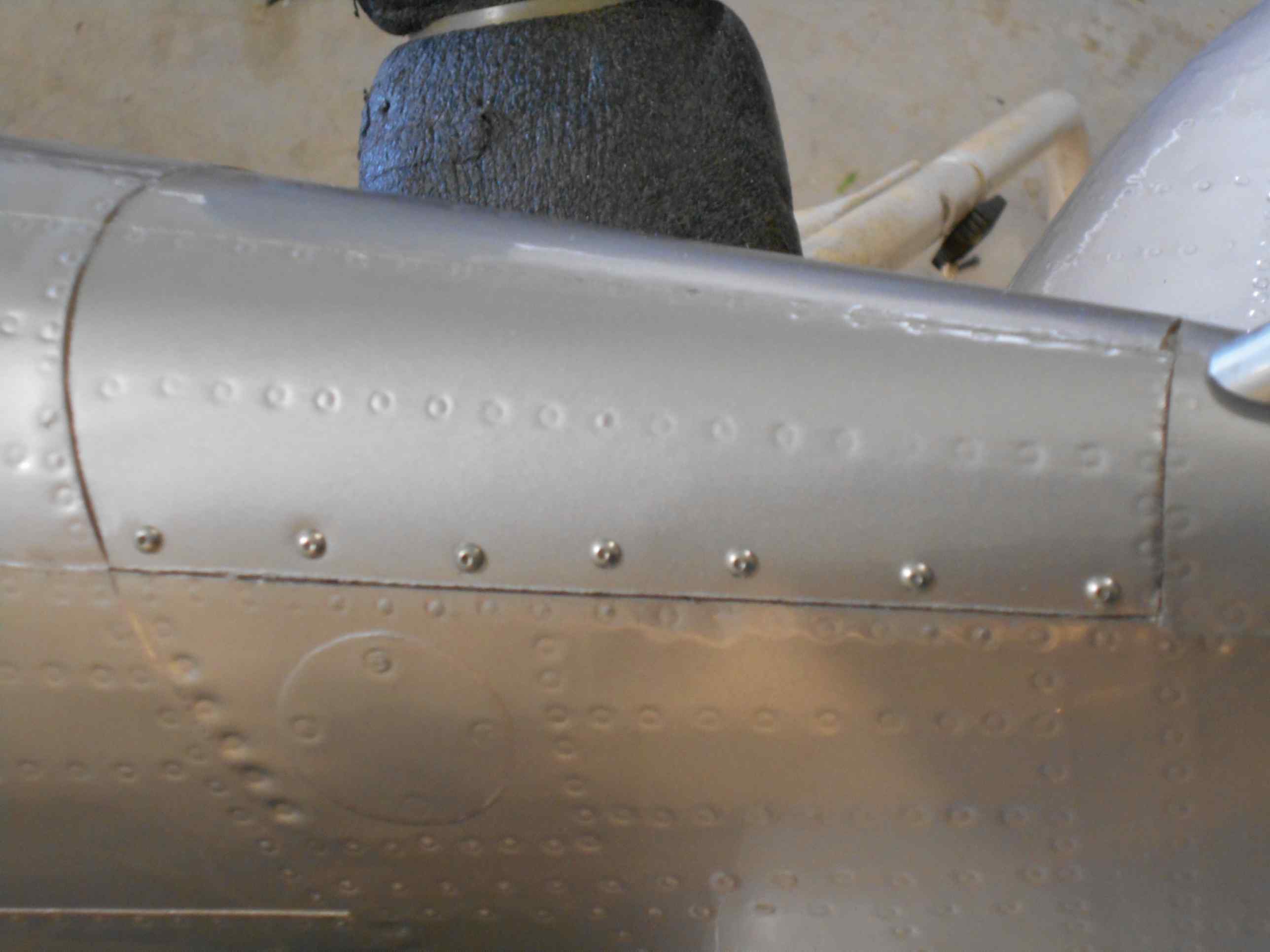

COWL ATTACHMENT

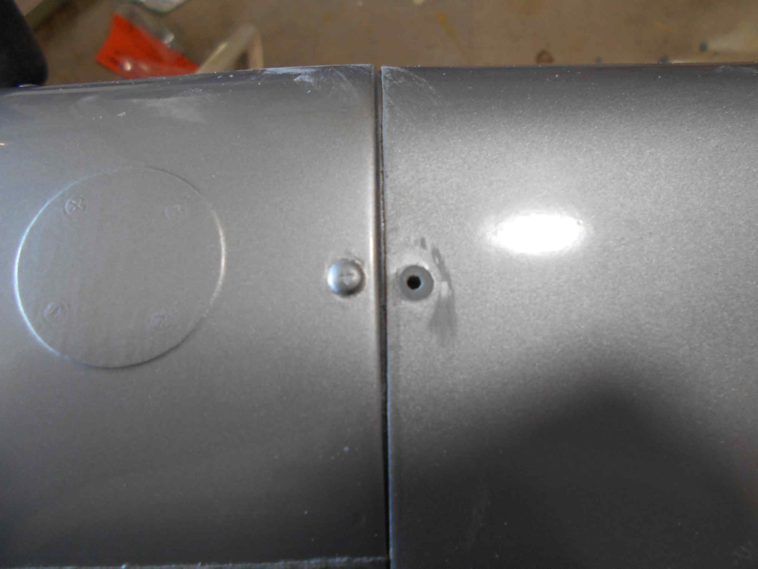

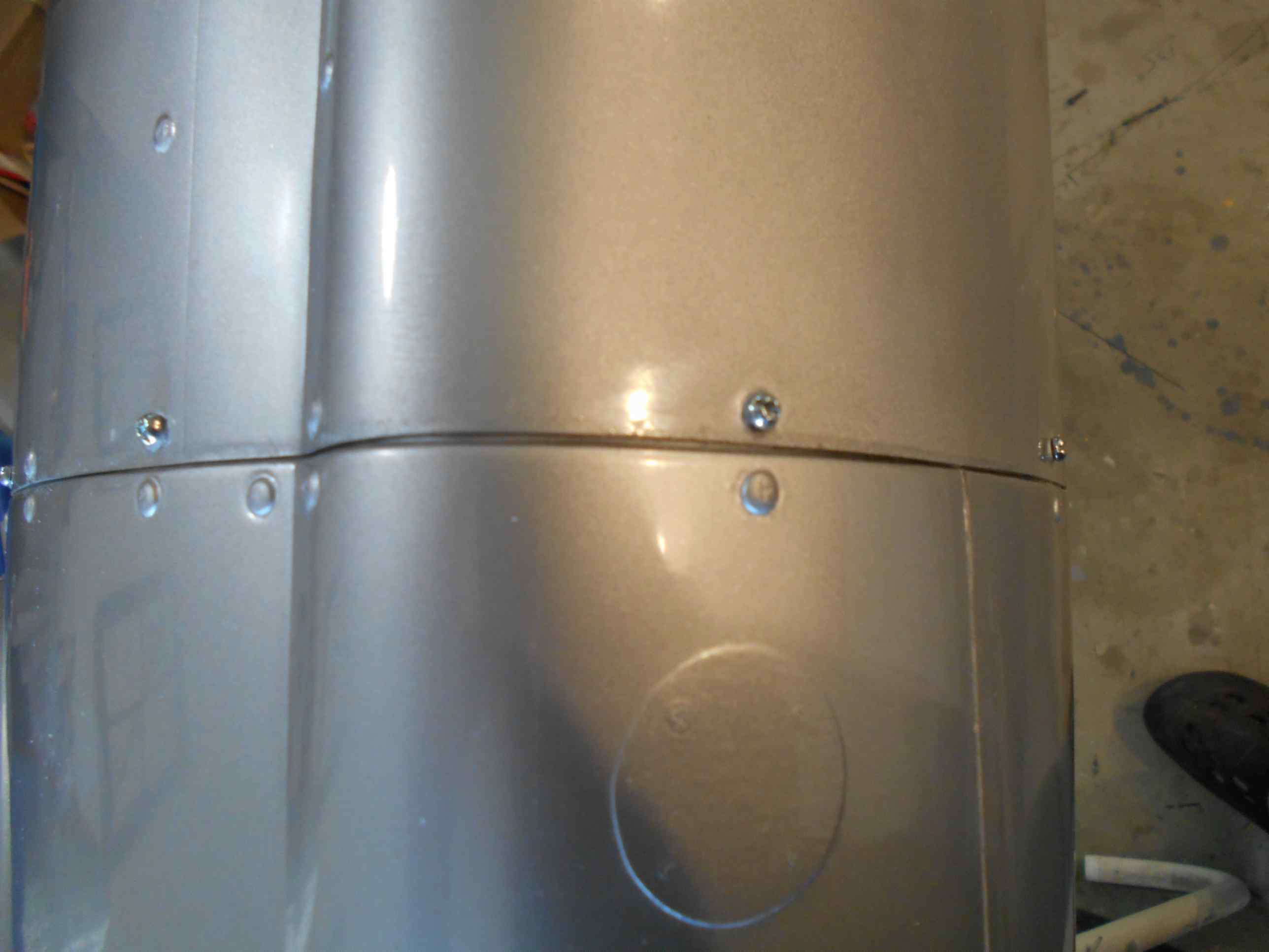

On the real aircraft all around the fuselage and Cowl, they used DZUS Fasteners.
But this CARP Spitfire was built with Exposed Phillips Head Screws as can be seen in picture 1.
To hold the cowl on, I can't duplicate a true Dzus fastener system in a logical timely manner, so I am going to keep what's there.
I found a 4-40 machine screw that has the perfect head diameter and with the combination Roberson Slot head is the same size in diameter and height. I had to sand the small bump down with a diamond file to have the screw sit flush.
To attach the screws to the inside of the fuselage, I used Wood Mushroom Caps used in the furniture industry to hide screw heads. I drilled then tapped them to a 4-40 thread. To hold them in place I used HYSOL 9462 glue.
I used a total of 8 screws and Mushroom caps.
The total weight gain for this was part of the build was 12 grams (not counting the glue weight).

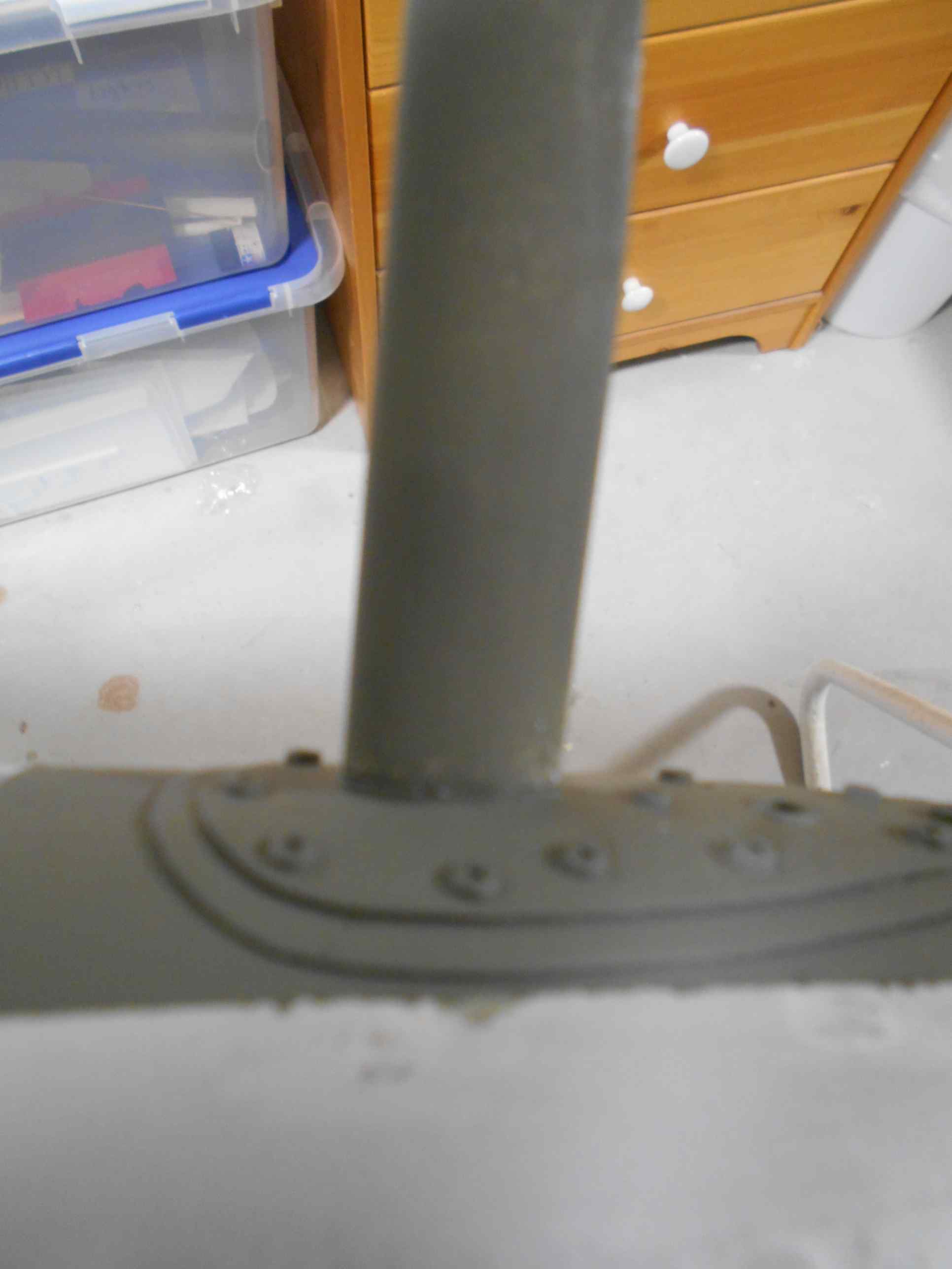

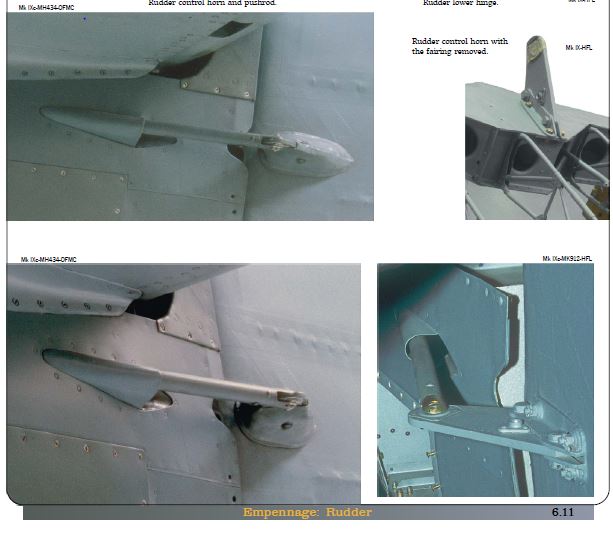

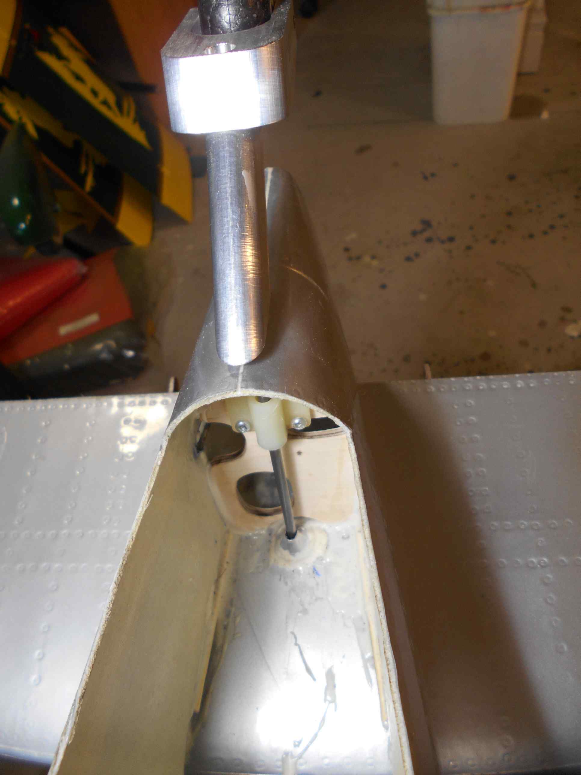

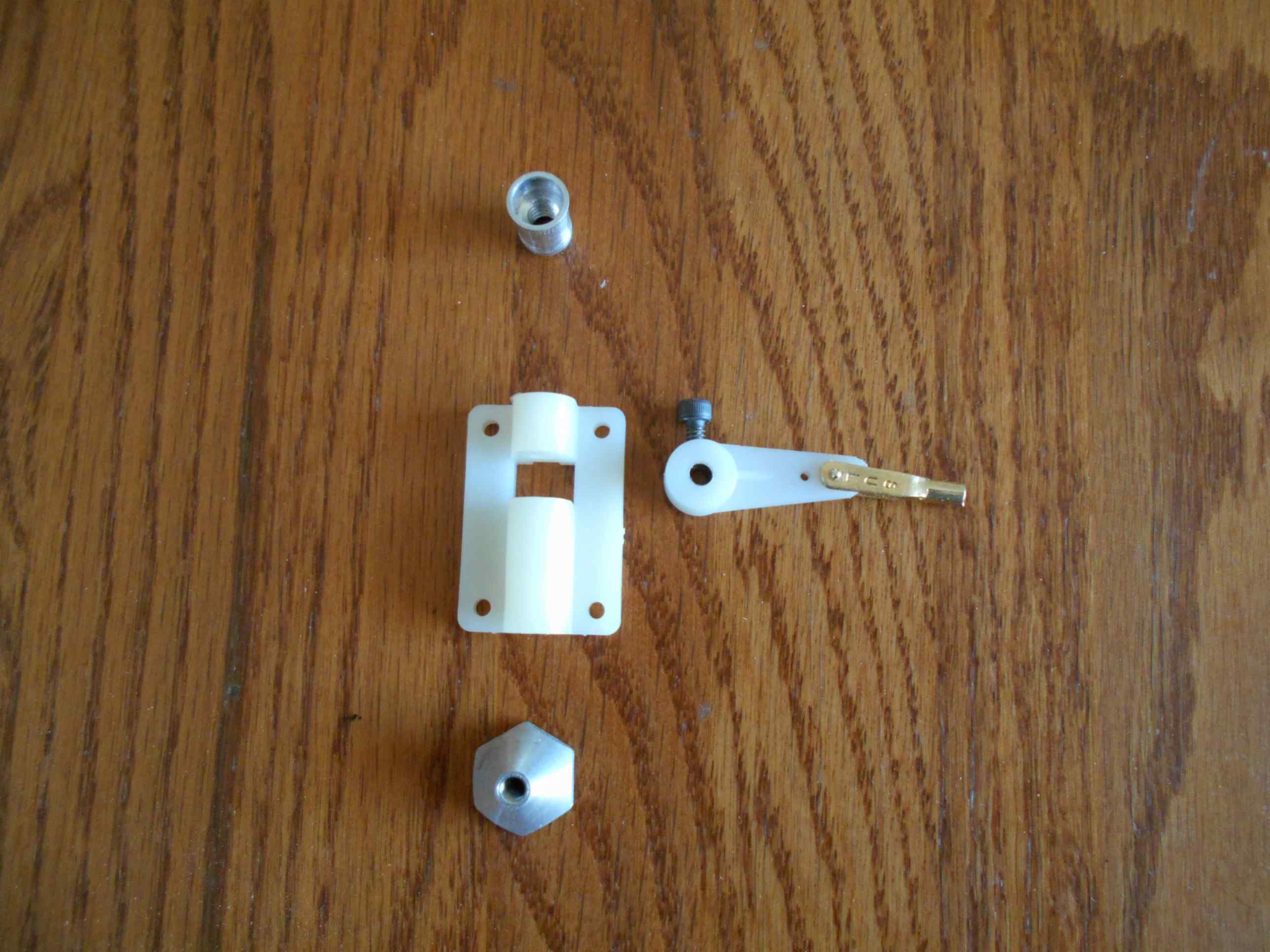

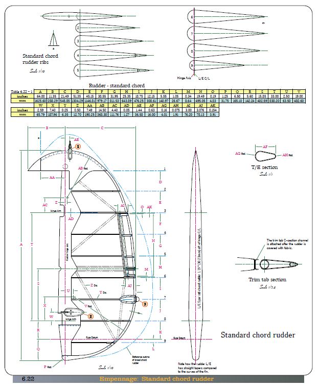

RUDDER DETAILS

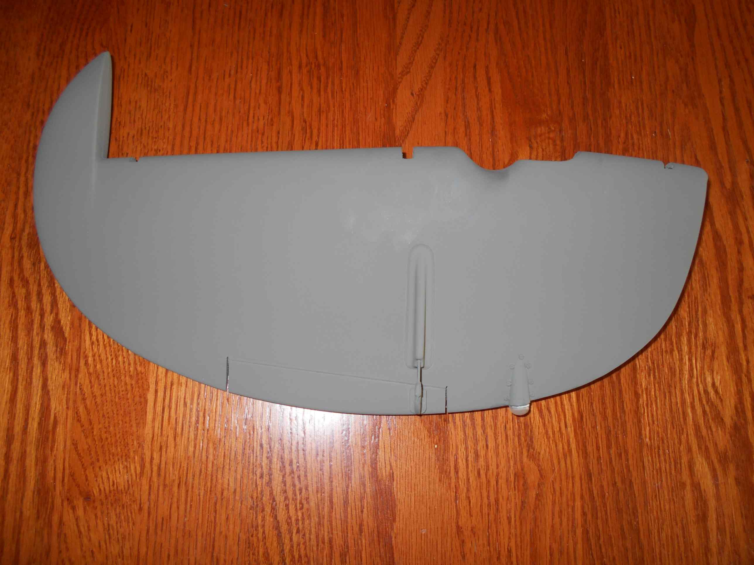

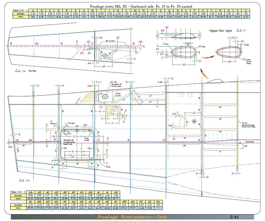

My goal is to add simple scale effects to the Spitfire that will stand out when you first approach the plane.
On the Rudder I have added the Navigation Light and the Trim Tab control mechanism.
I found the "Perfect" Light Bulb 0.375" in diameter at Advance Auto.
For the Trim Tab components I purchased them from Nick Ziroil.
https://ziroligiantscaleplans.com/pl...cessories.html

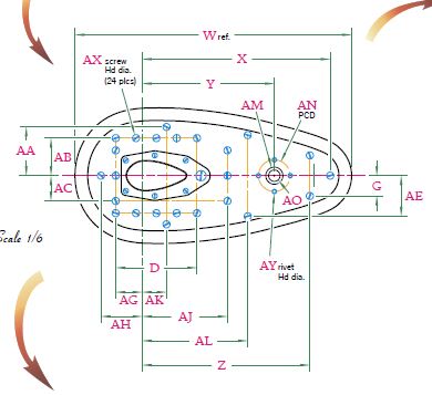

The MONFORTON book gives every dimension that you would need to put the light and trim tab in the proper location.
The Rudder control on the spitfire does not use our traditional Pull-Pull system so I had to compromise a bit to make it look somewhat real and yet be quite sturdy enough.
I scored the hinge line for the trim tab and added a tiny thin wire to give it that more scale look. After sanding the components down I painted it uses a Etching Primer.
The original weight of the Rudder was 82 grams and it is now up to 112 grams. Unfortunately at the wrong place to be adding weight to a war bird, but I believe the engine is heavy enough to compensate for this tiny increase.

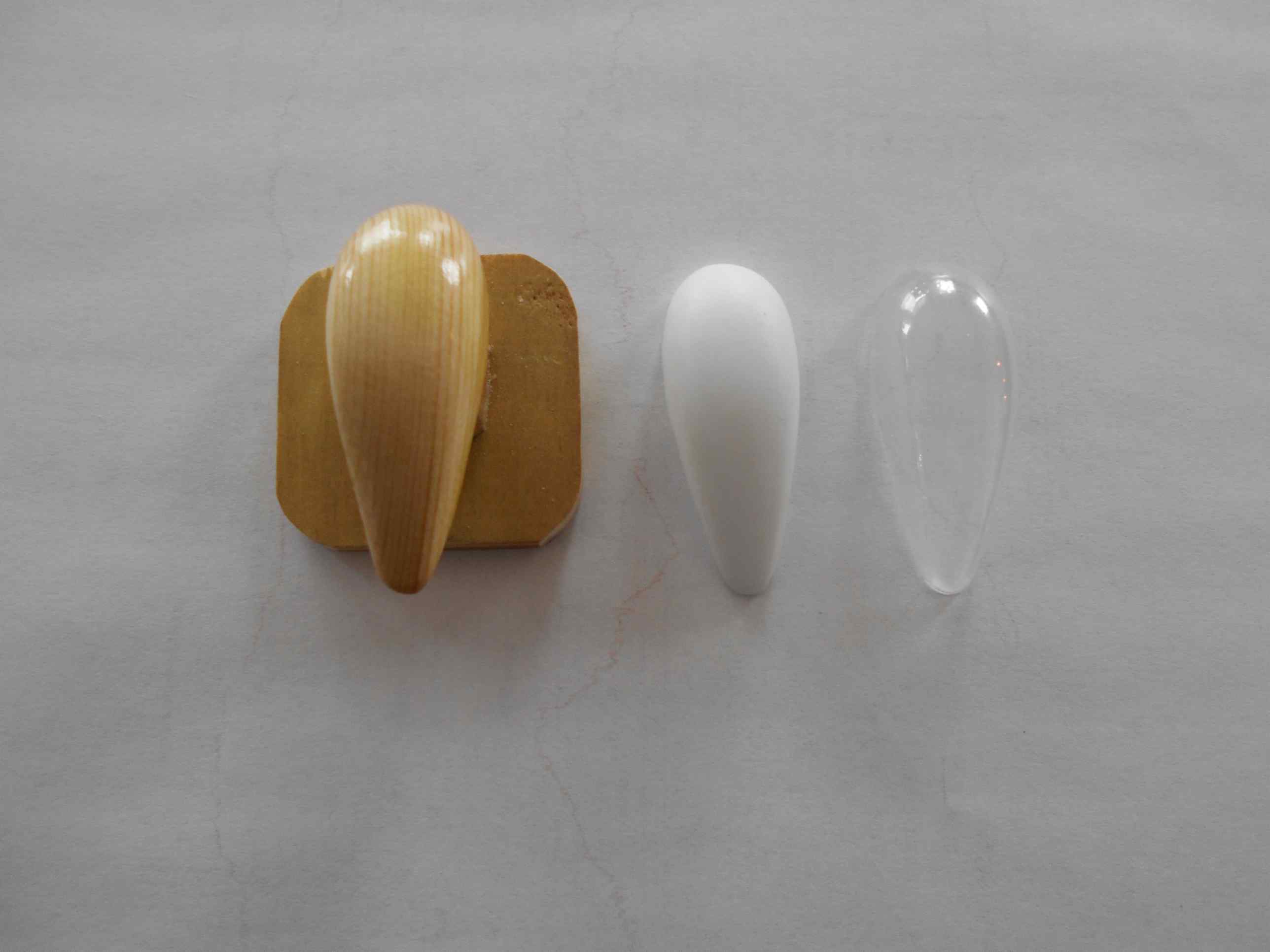

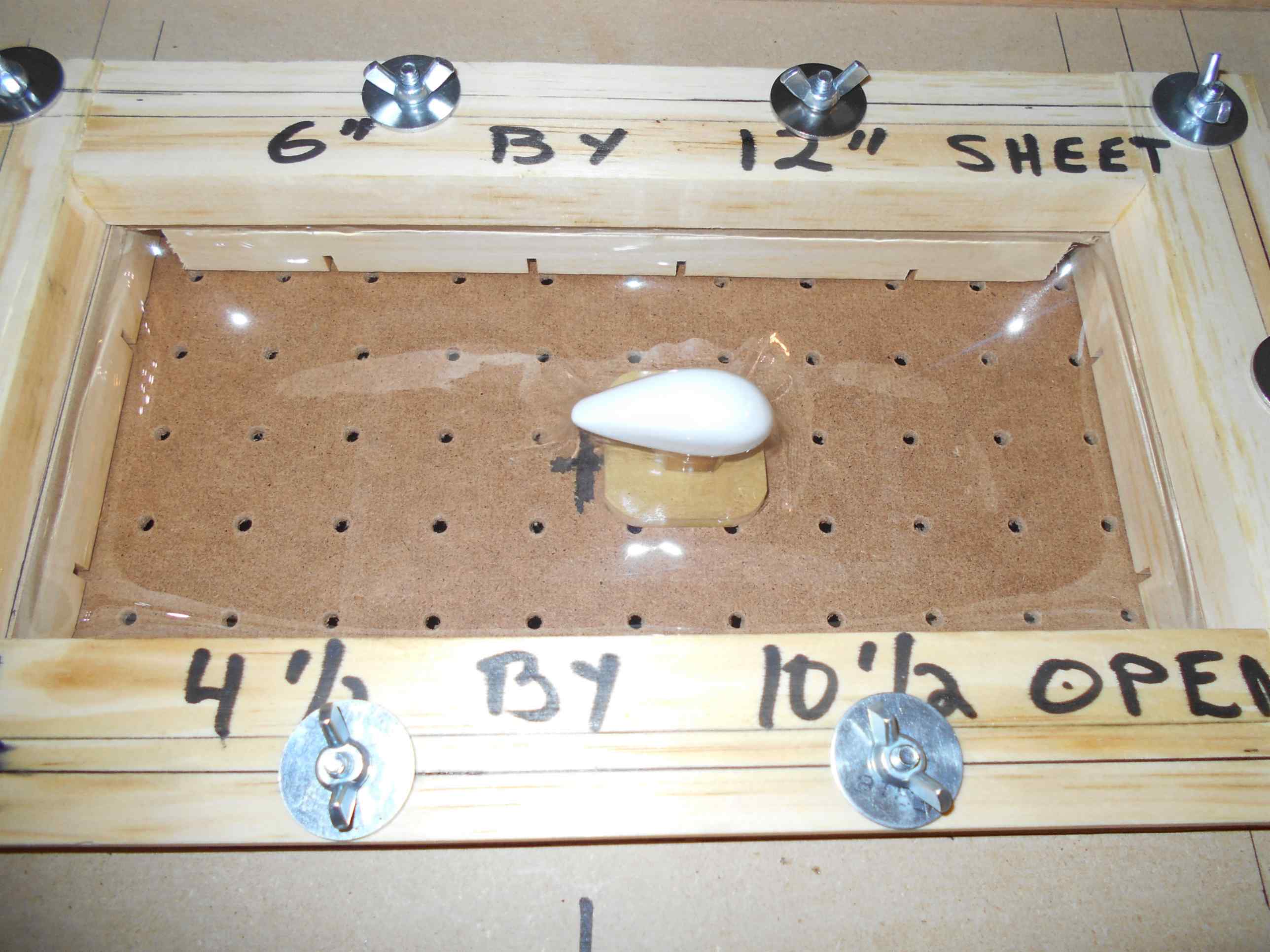

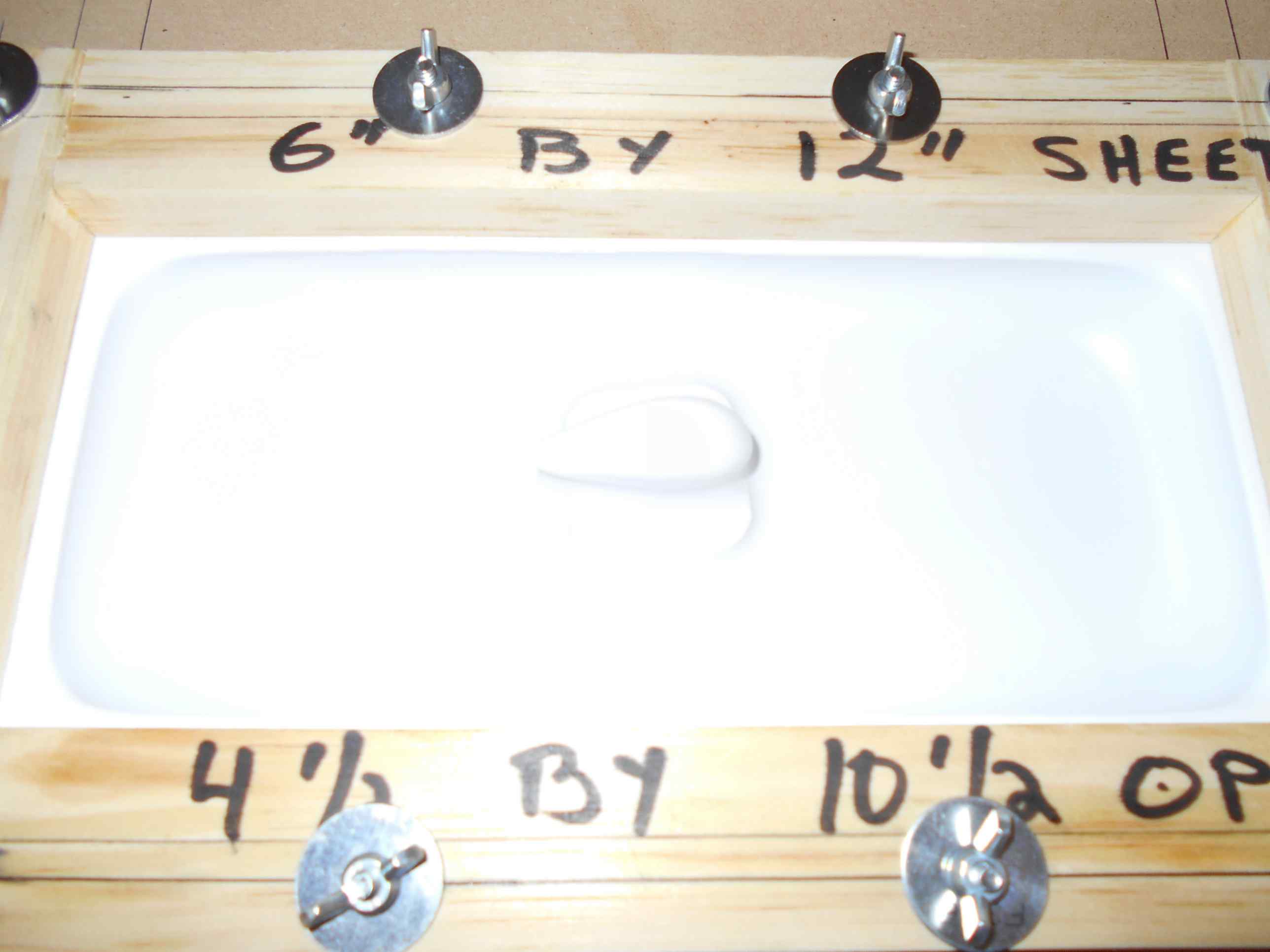

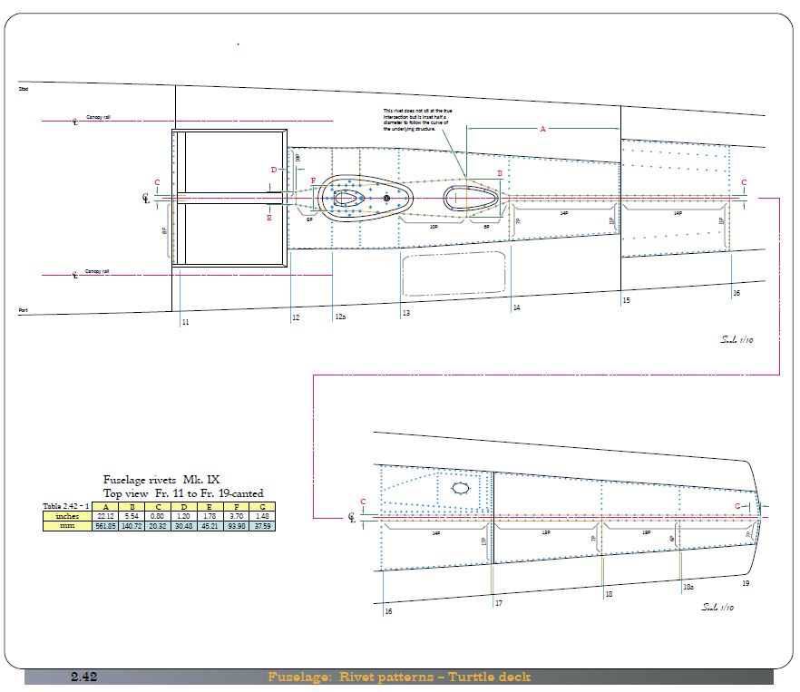

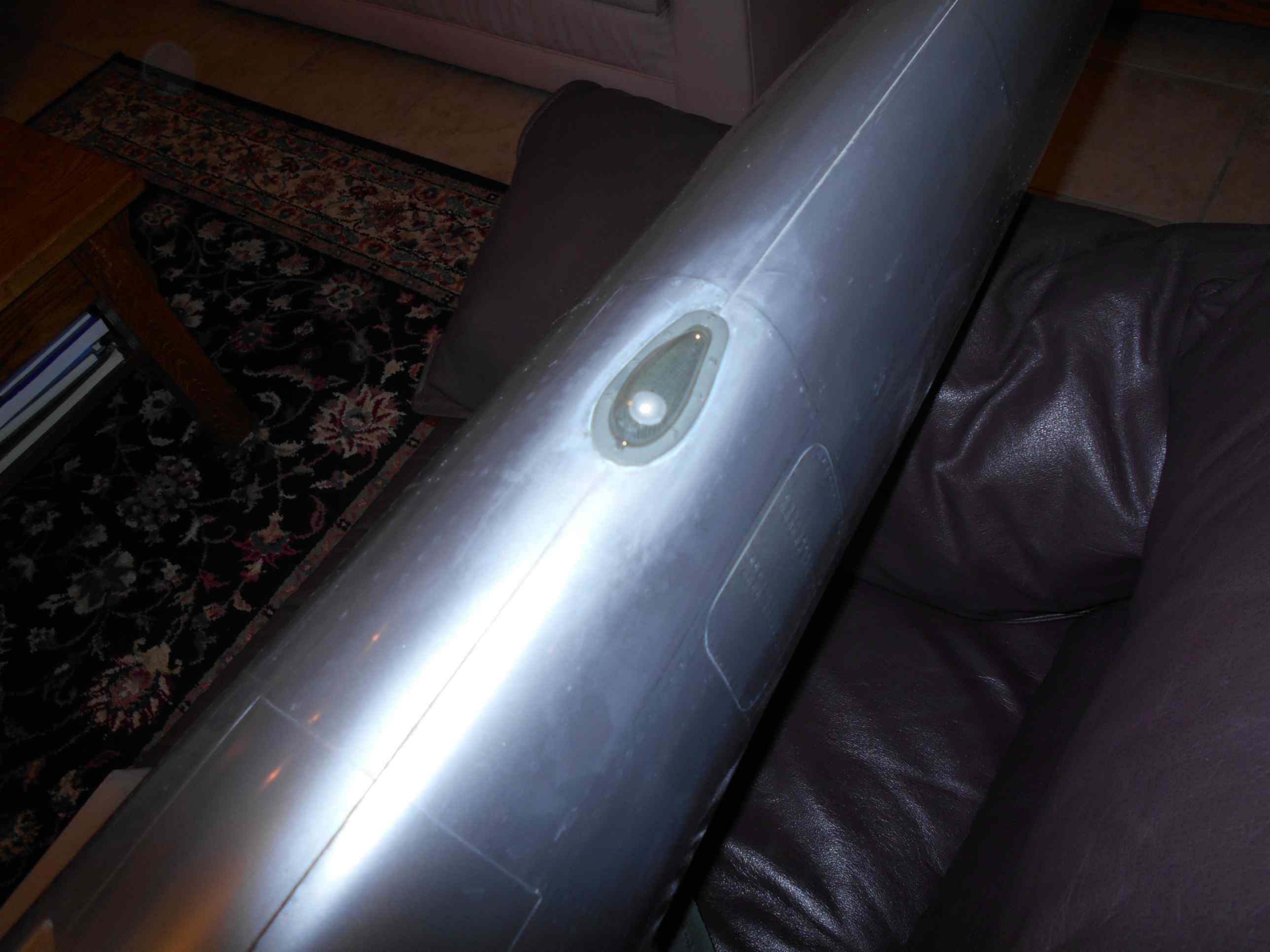

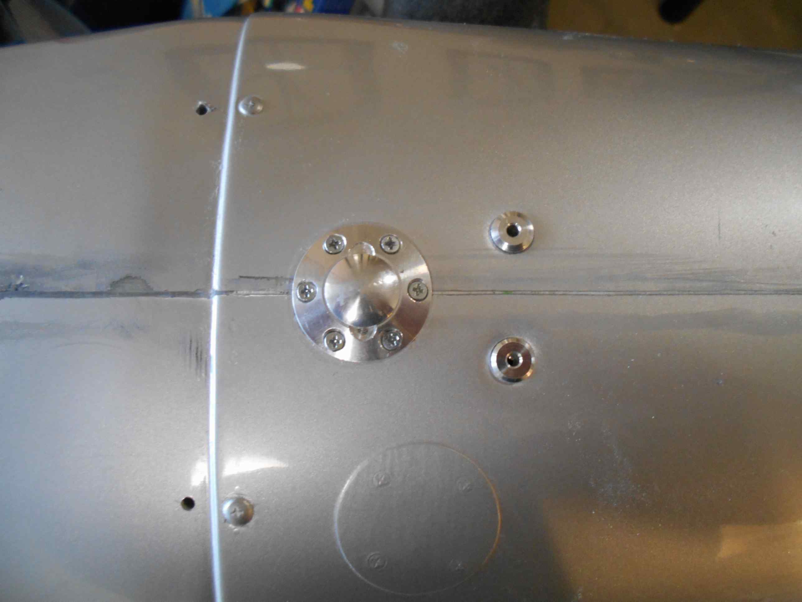

UPPER NAVIGATION LIGHT
This was my first try at Vacuum forming. John Allen lent me his box to make the dome light.
For those that are new to this it does take some experimentation, but the results are certainly worth it. I made a wooden plug "tried Balsa but like soft pine better). After putting on several coats of Urethane I then pulled a 0.015" styrene part. From reading others vacuum trials, this acts as an excellent base to pull the clear plastic over. It produces a super smooth finish. I tried making the clear plastic part from 0.015" plastic but it just was not rigid enough so I ended up using 0.030" material. This produces the perfect strength of part.
The light bulb comes from Advance Auto at the correct diameter of 0.375" for a 1/4 scale plane. The mounting plate is made from 0.030" styrene that is held in place with some #0 screws. The inside was painted with an etching primer that has the "Almost Right Look" for any interior metal parts on the real Spitfire.
When ready for painting the mounting plate will be the correct colour of the fuselage, just the interior where the bulb is will remain green.
The net gain in weight to the fuselage for this small scale feature was 18 grams.
Again the MONFORTON book gives all the dimensions for you to make your own Navigation Light.
And again don't loose sight of the overall game plan, this is a Sports Scale Plane and minute deviations are accepted as long as the "Message is There"!

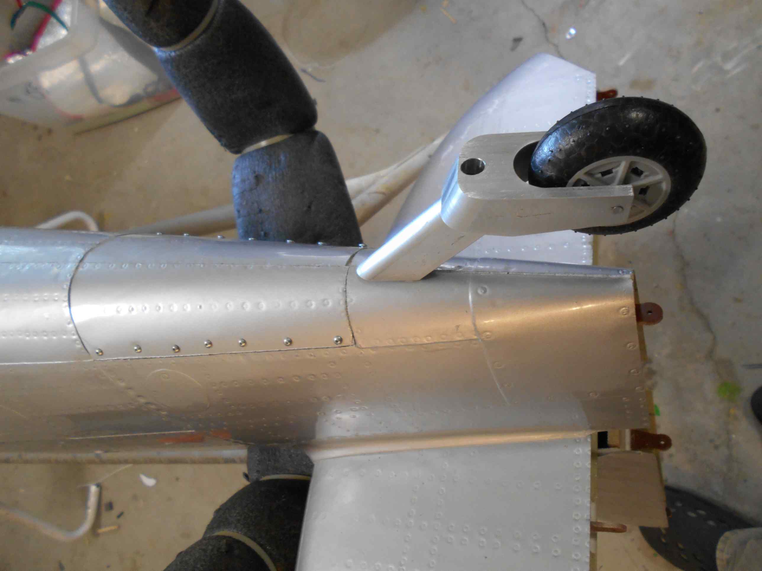

Taking a short break from the Spitfire build to head south to Joe Nall with Jim Bisson. We leave tomorrow at 7:00am.
Roger "Ramjet" came over tonight and helped get the Landing gear to sit flush on the wood mounts. Thanks Roger.
I will be back at it in 12 days!

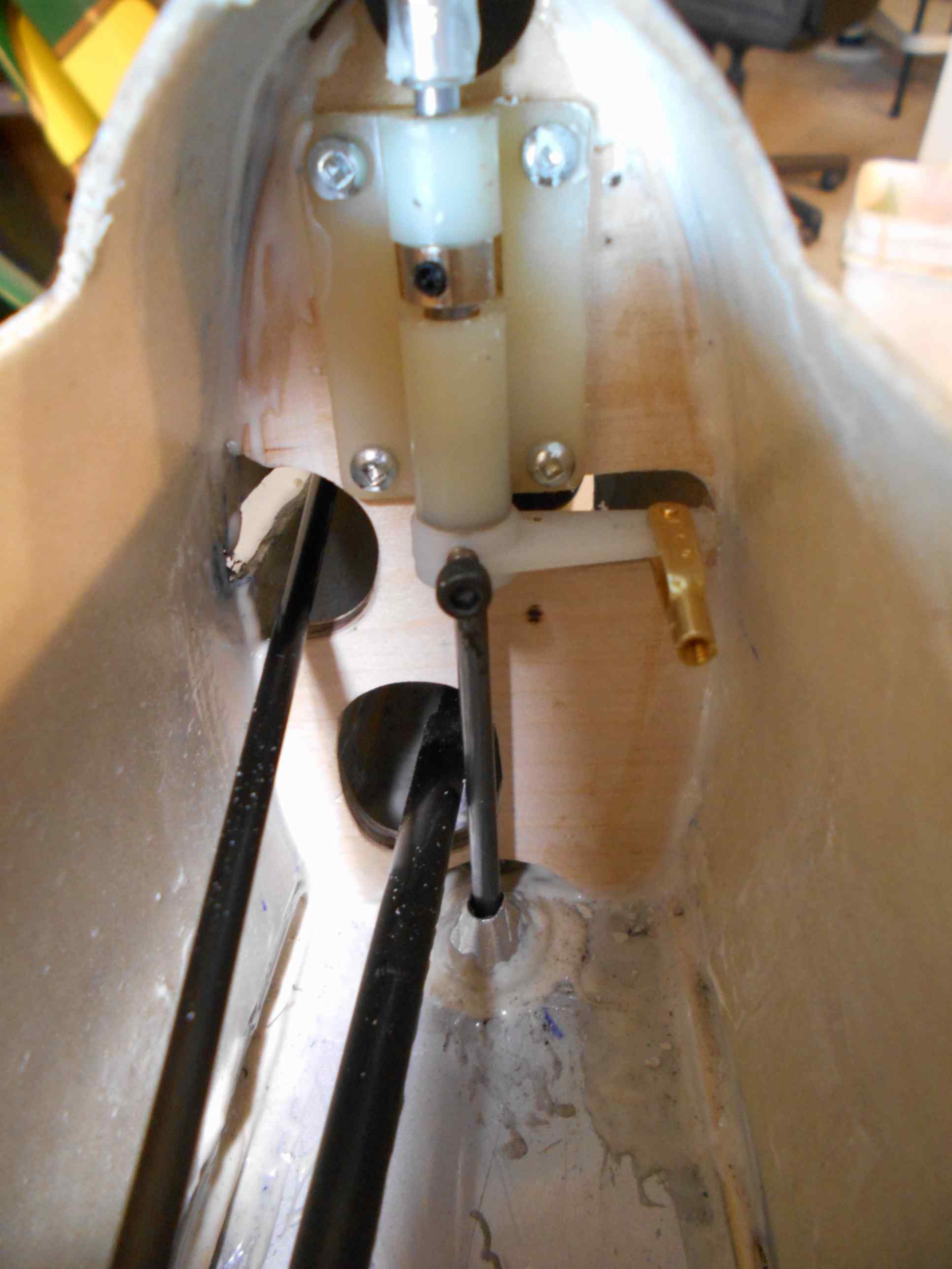

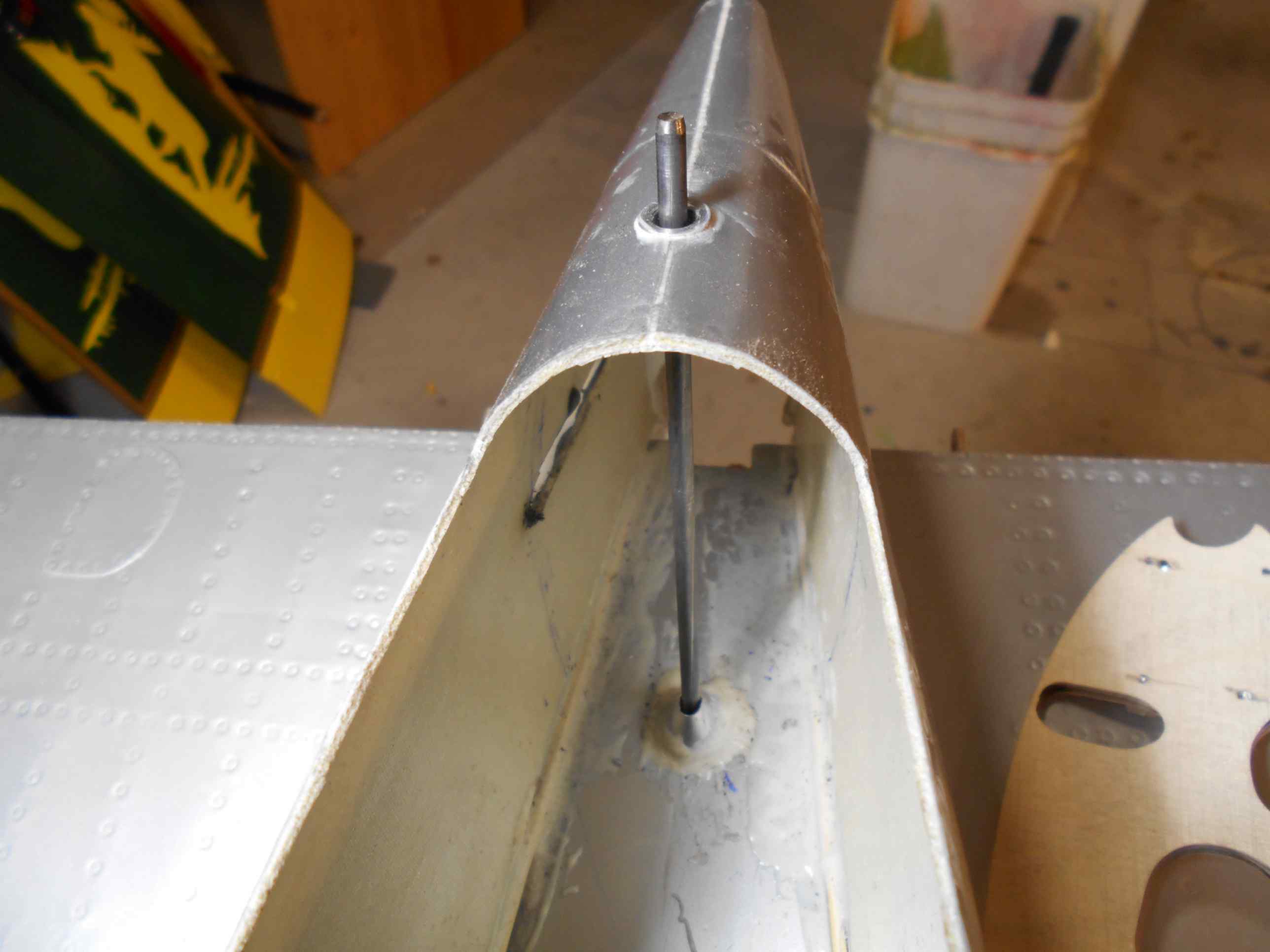

ELEVATOR CONTROL SYSTEM
Well I'm back from 11 great days at Joe Nall. There were four other Spitfires (3 from Germany) that I got to watch fly and take lots of pictures on how each one did some unique things to their planes.
The control of the elevator is done with a long carbon fiber shaft that has two ball links attached to it.
I personally like to use the SDS carbon fiber tray to hold the servo and use the auxiliary ball bearing pivot to reduce the stresses on the servo gear train.
These are available at SDS Hobbies SKU SACF20111 for $17.29.
I am using Savox Brushless 2270 servos on all of the flying servos. I have had great success on all of my other planes using them and they don't draw a lot of power during the flight. The torque for this servo is 444 oz. inches at 0.12 seconds.
I did learn that the elevator on this Spitfire design is very sensitive and you need a lot of Expo around 65%. On landing about 1mm of down is required when the flaps (really an airbrake) are deployed. Two of the German flyers (who are part of a massive 9 plane war bird flying event at the noontime show) both use some Butterfly in their aerilons during landing. There is no mention of this in the Carf Manual.
Here are the weights of the items added to the Spitfire.
Control Rod with 2 Ball Links 52 grams
Elevator CF tray with Control Horn 32 grams
Servo with Arm and 2 Ball links 80 grams

TAIL WHEEL BRACKET
I have had too many visits to three hospitals and I don't know how many doctors to let me work on this project. But finally I have been able to get back to it.
I decided to go with a Steerable Tail wheel and opted for one made by Shindin Machine http://www.shindinmachine.com/SPITFIRE/SPITFIRE.html.
This tail wheel uses the same steering technique as a trike nose wheel.
My first step was to install two aluminum bushing mounts to control the 5/32" steering rod. These were put in place with more Hysol EA 9462 Locktite glue.
Next, I made the vertical support plate out of 3/16' birch plywood. As you can see there are a lot of holes in it for the two pushrods and for the steering arm. Making this part takes a lot of time getting the correct profile shape. I first made a card stock template, followed by a balsa template and then a thin plywood template. Once that I was happy that I had the correct profile shape with the holes in the proper position and large enough, I made the final 3/16" birch former. I sanded the sides at a 6 degree taper so that it would fit snugly against the fuselage.
Total weight for just the former and its supporting hardware is 39 grams. This does not count the tail wheel and the control rod!
Next is to build the tail wheel servo box.

TAIL WHEEL CONTROL SYSTEM
I opted to put in a Hitec 5087 metal gear micro servo to control the tail wheel. I will program (using a separate channel), this servo to my rudder and will then be able to have it work in the right amount for deflection when I use the rudder for steering.
http://hitecrcd.com/products/servos/...servo-/product.
The servo tray is made from items supplied by Carf for this kit. I plan to assemble the aerilons using a different holding technique, so this wooden tray was available. Again I used Hysol Locktite glue to hold it to the side of the fuselage. If I need a larger servo, the tray is easy to open up the space to slide in a bigger style of servo.
Weight for the tray was 18 grams and the servo was 22 grams.

Attaching the radio antennae to the fuselage left me with a challenge. I have seen too many war birds where the antennae has been broken off when the plane is turned upside down for assembly. I wanted to make mine EASILY removable for transportation.
I found some teardrop tubing used for struts that was just the right width. I also had an plastic insert for it that was shaped so the end would be able to pivot against the fuselage. I think this is old Byron material I had laying around.
I shaped the antennae per the dimensions in the MONFORTOM book. I added a second piece of the shaped tubing to the inside of the fuselage and place the two piece base around the tubing that is inside the fuselage. The plastic insert is glued to the antennae and the remainder of the insert is now able to be forced into the fuselage tubing.
It is a very difficult part to assemble or remove so I have NO worries that it will be lost during flight.
